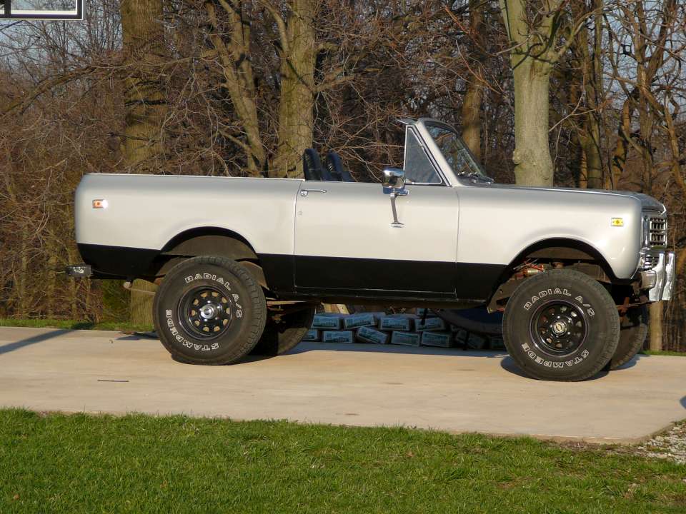

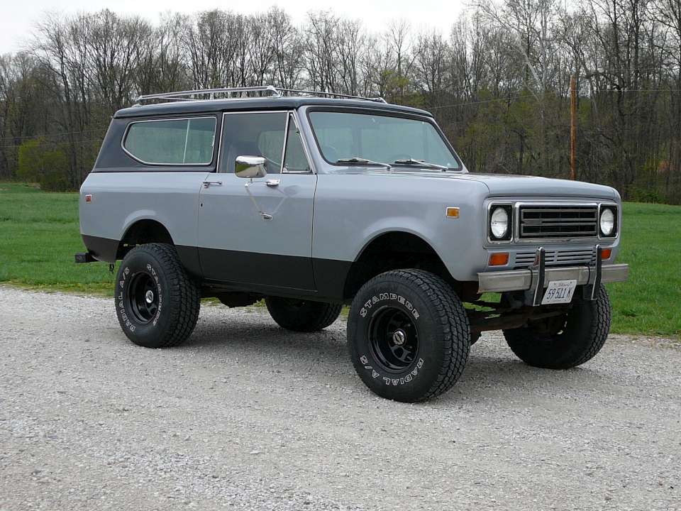

Just thought I'd post a few pictures of what my '79 Scout has gone through since it was born...

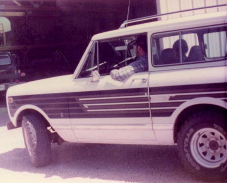

Stock. Dad bought it new (that's him driving).

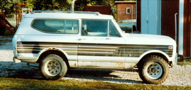

After high school body shop to "fix" the rust and all the dents I put in it while driving it in high school.

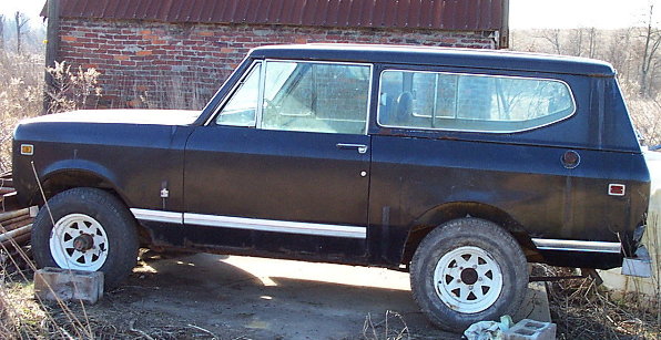

After sitting in my parents' pasture for 10 years.

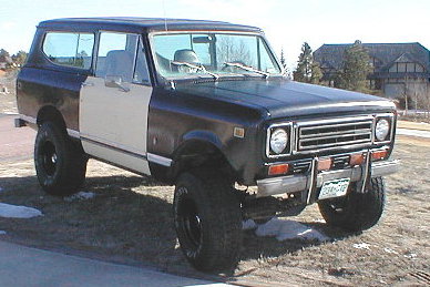

SOA by D&C, 33" tires, "new" doors, complete overhaul of the 304 and 727.

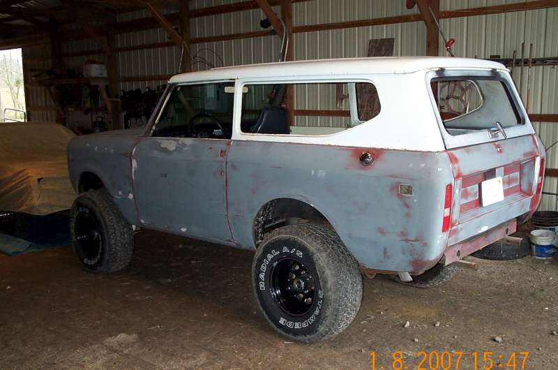

New everything (almost). Chris Keck is to credit for this work. He listed everything he did to it in a post below.
Prepped for paint
And the finished product.

Signed sealed delivered. Sweet man. Last time I saw your scout it was at Kecks getting the body work done. I cant belive how in-depth chris had to go to get the rust out, but I know its as 'Rusty Free' as it can get. He even got into the trans tunnel, replaced most (if not all the step up to the bed) and replaced just about everything else.
Quite the job. Glad to see it back in your hands. Can't wait to see where it goes from here. Make sure you put some serious undercoating on that thing ~ or just don't drive it in the winter.
Keep posting pictures as it progresses.

I like it white myself. I replaced, both Inner/outer rockers, all 4 rocker extensions, both front floor pans, all 6 floor supports, both front cab mounts, both center cab mounts, Lower front fenders on both sides, fiberglass 1/4's both sides, 1/2 of both inner 1/4's, both tailgate pillers, tailgate, patched the rear cargo floor, replaced the top, windsheld frame, DS door, all 4 kick panels and i'am sure i'am missing something. Not much of it wasen't replaced. Diffently keep it out of those winters and it should last a long time.
