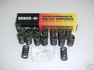

I found a better option for a performance valve spring that should be a drop in replacement for the stock spring.
But back to ebay I went...and I found these.
I use the BBC springs and the retainers.
I reuse the IH exhaust rotators.
ERSON VALVE SPRINGS FOR A HYDRAULIC CAM (PART NUMBER E915011). THEY ARE SINGLE SPRINGS WITH DAMPER, MADE FROM CHROME SILICONE MATERIAL, AND WILL WORK IN MANY APPLICATIONS, SUCH AS BBC, BB MOPAR, FORD 351C, 351/400M, 429/460.
HERE ARE THE SPECS:
1.500" OD
95# @ 1.820"
313# @ 1.180"
1.080" COIL BIND
.640" MAX LIFT

Well we have all heard the stories about the IH valve springs being weak.
So when I built my motor I used big block chevy springs-BBC. I run my motors hard and frequently exceed 4000 rpm. I'm sure it contributed to the failure but i think my EBAY springs may have been used springs!!
I will say that having the inner damper springs probably saved my motor.
A valespring failure normally results in the valve falling into the piston and destroying everything!!
EDIT:
HERE ARE THE SPECS:
1.500" OD
95# @ 1.820"
313# @ 1.180"
1.080" COIL BIND
.640" MAX LIFT
