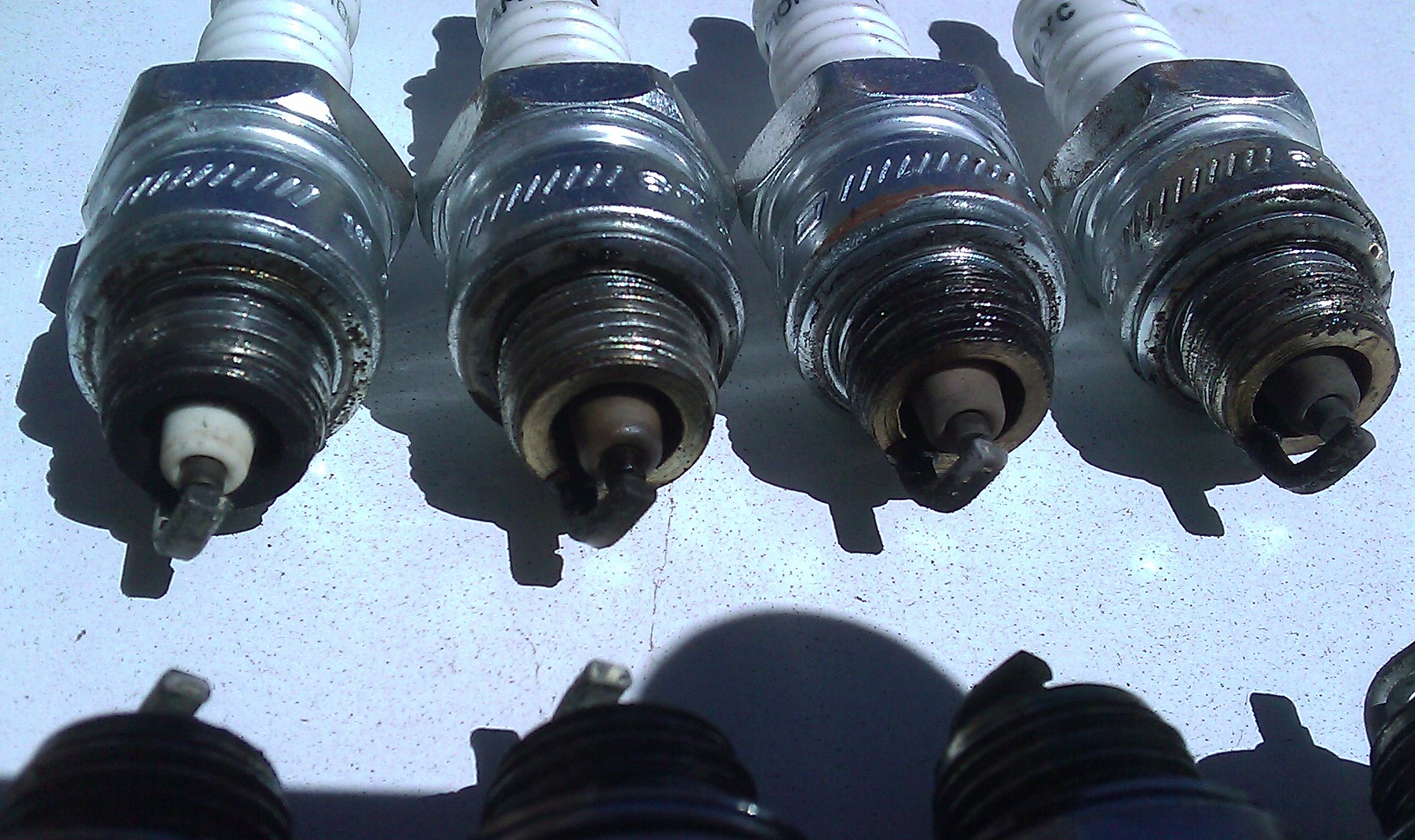

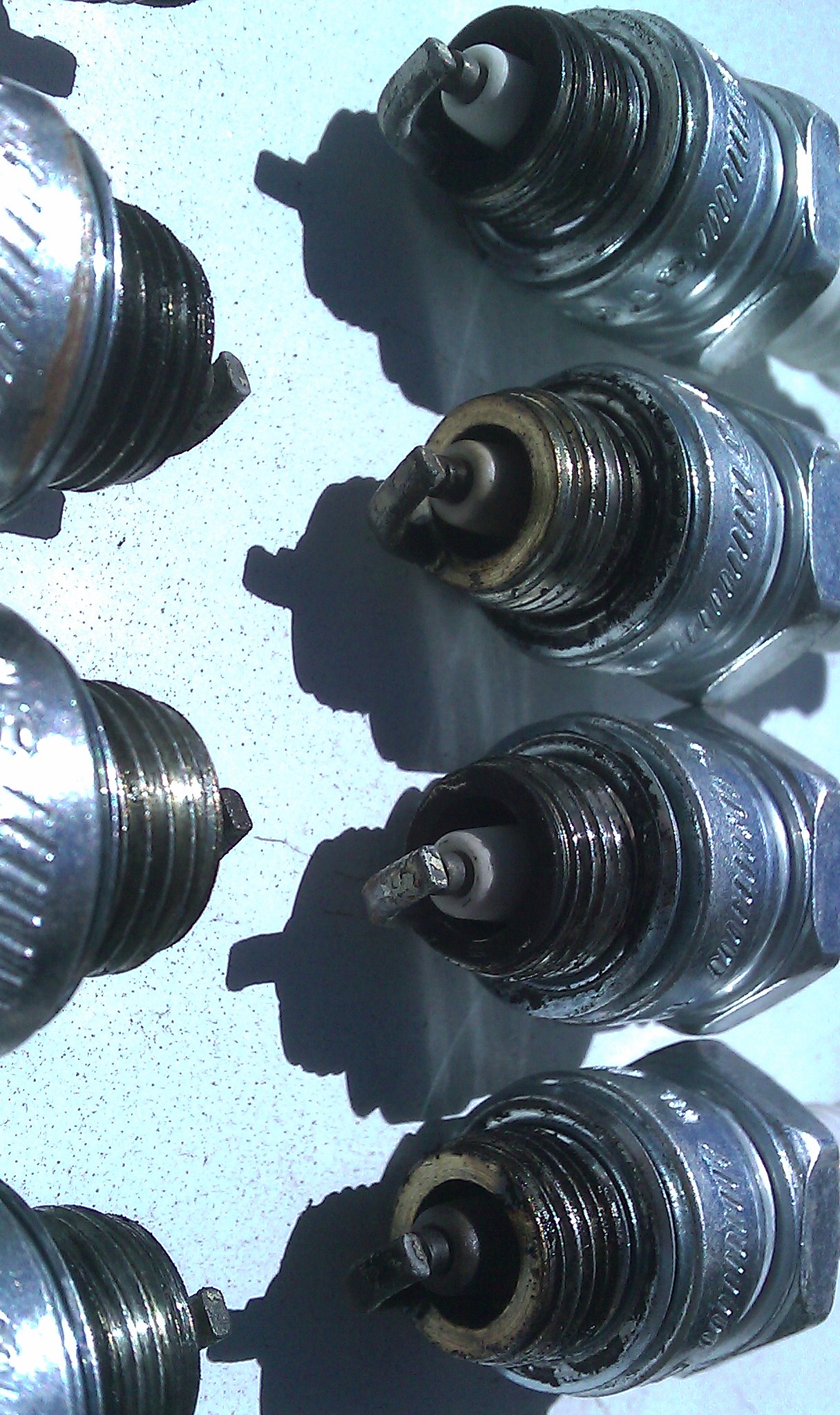

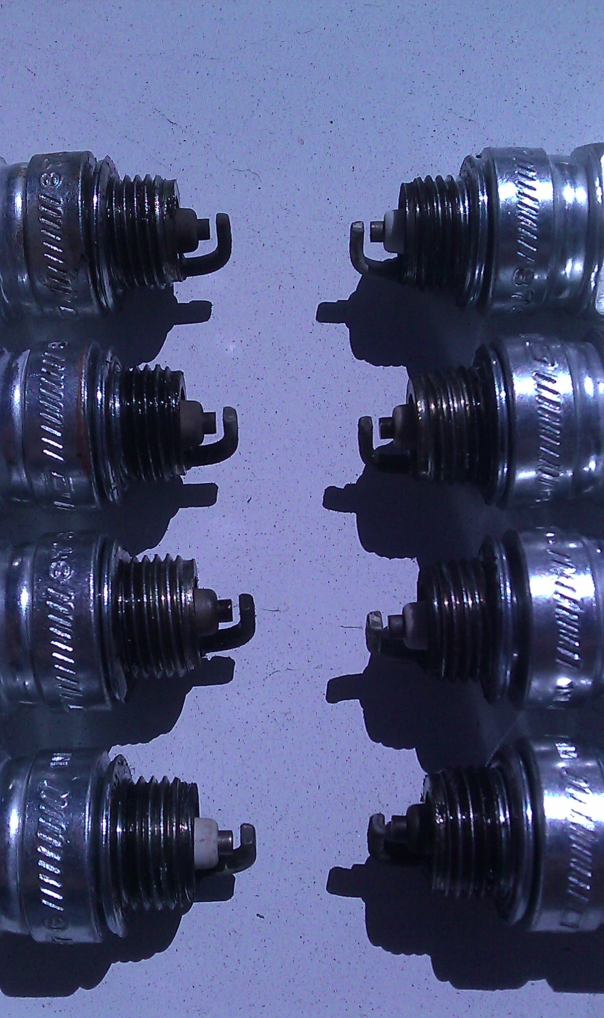

Default Plug reading and fuel distribution in 392.
In order as if you' were looking at the engine from the front.
What do you guys make of this? These plugs were put in, I tuned the carb using the vacuum method and it idled and free rev'd great with no smoke and no issues. I then drove it around the block and it acted lean and it started to misfire so I limped it home and pulled the plugs to take a look. I've never seen such a variation in color before. Is this normal for a IH 392? I have a holley 4010 Carb and just rebuilt it.
1 and 8 look too rich. 2 and 7 look too lean. The rest look pretty close to me.
Why is the mixture distribution so weird? By the looks of this it might be misfiring because 1 and 7 are too lean. If I richen it then 2 and 8 are going to be fouling and the middle 4 won't be as good as they are now. I don't get it.
Other then converting to multiport EFI, does anyone have any advice?
B
Reply With Quote
