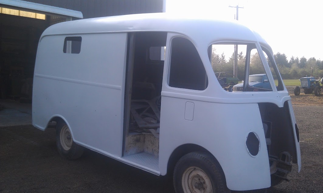

Default Re: 1946 K1 Metro Restoration Thread
Mike is done with the big stuff!!!!
Now I've got to go find John D and make sure he's ready.
Just need to put in a new timing chain into the mercedes engine and the marriage can begin.
cheers and happy friday!

WOW that looks great.If you didnt notice it looks like there is a dent in the second picture on the roof inline with the back of the door.
Jeff
SHHHHHHH
i know
i know
i know
there is also a hole in the step-up / wheel well in picture 3
as well as a gap in the half-round in that same shot that will be a rust magnet
but still ... i am over the moon and ready for the next step!
