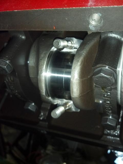

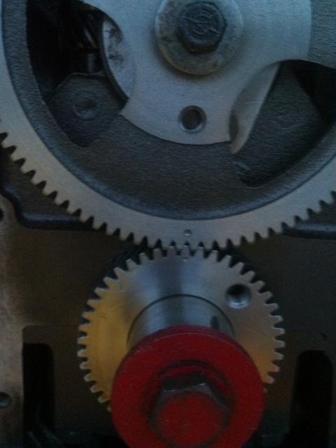

I haven't spent 15 minutes in my shop in the last month or two thanks to work.. but after waiting for the engine to arrive (the scheduled 7am-before-work delivery was delayed to noon) last week I managed to check a few critical items and get the crank to the machine shop again.
Robert was concerned the timing was off, but the marks line up.
That doesn't mean the cam wasn't ground "off" so I will degree it when I can get back to it - that requires the crank, though.
This, however, is why the engine had to come back out.

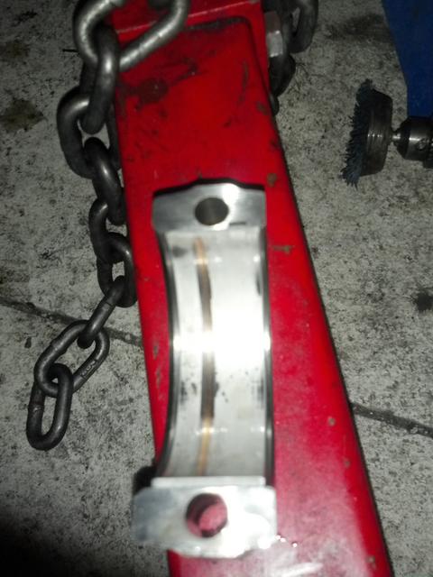

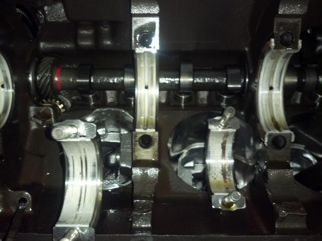

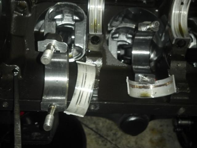

John Fleck of BCB happened to call to chat about something or other, and off-hand mentioned a 196 he had just built and had to tear back down because he had been sold the wrong rod bearings and wiped out the rod bearings in about 8 minutes.
A little more research and you'll find "everywhere" that says the V8 and 4cyl rod bearings are the same. I believed it.
Turns out, they are not.
The V8 and 4cyl connecting rods are also different.
On the V8, two rods sit on one journal and oil squirts out between the rods.
On the 4cyl, the rod sits right up against the crank journal on both sides, and it's hard to get the oil out.
So the oil gets hot, the oil break down, the bearing fails, and you get a knock.
It was important to fix this before it gets to PA!
You can see the scoring in the bearings and crank from the short time Robert was running the engine.
This picture shows the oil relief hole in the rod..

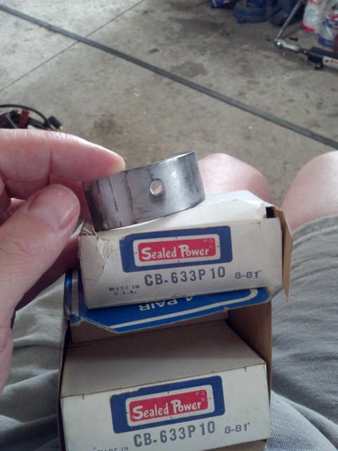

John informed me that the he was told the correct rod bearings were obsolete and unavailable, though they can be found. He was working on getting a cache of them on hand. Meanwhile, I started scouring for some before the engine even arrived, knowing I was going to need them and needed to fast track getting this back together.
I found some in Puerto Rico. Obviously, these are NOS.. these are dated 1981.
You can see the oil relief hole.
I bought the 010 size because I was afraid I might need to source another crank, and again, I was looking to shave some time off of this.
It's likely the crank can just be polished and re-used as-is. I have a set of 020 bearings (from 1984) along with some 040 just in case.
My oldest daughter and I dropped the crank off on Friday, and while the crank grinder was out of town over the weekend, he was supposed to get the crank today or tomorrow.
Once the crank is polished, I can put it back in, and then check the cam timing to see if it was ground "off" or not - if so, I can adjust the cam timing by offsetting the timing marks on the gears and "fix" it.
-Tom
