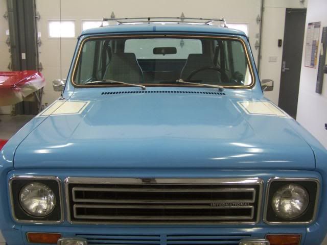

    I haven't posted for a while, been busy on the current project. This is very similar to the last one: http://www.binderplanet.com/forums/showthread.php?t=80859
    This one, however, is much much nicer to begin with. A little over 61k original miles and totally unmolested. The owner wants to have a very nice, reliable driver, so we will be doing a total restoration on the body and interior with mechanical repairs as needed, doesn't need much. I recieved this at the end of January 09 and started working soon after.
    If anyone needs a picture of basically any part of such a Scout for reference feel free to ask as I have a picture of about every square inch of this truck. It was all there and untouched so great for reference. I will be posting pics from here on out but just to get you up to date here are the pictures so far.
    Before, really nice!
